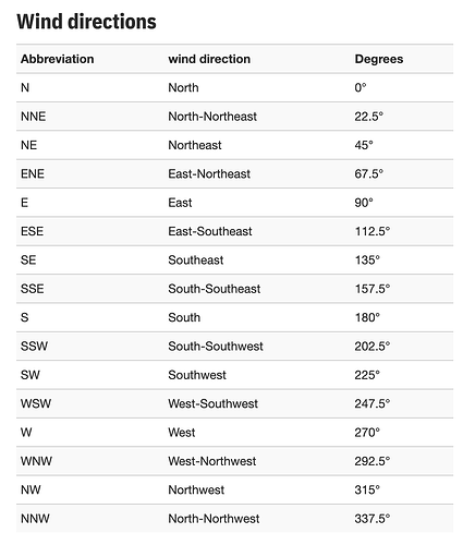

Completed per this chart:

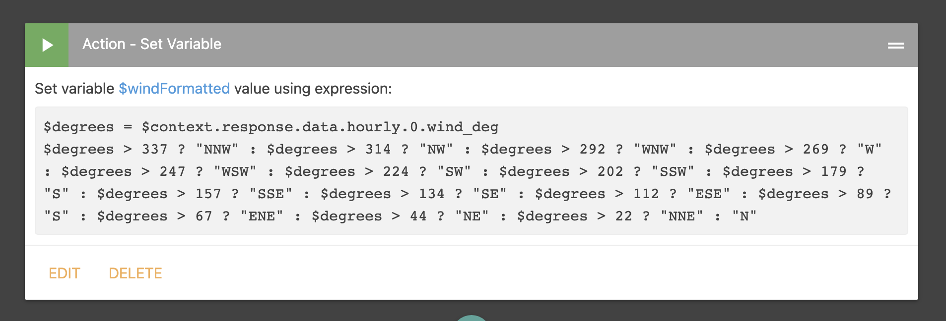

Something like this:
$windFormatted would be your variable that would hold the cardinal/compass direction.

$degrees = $context.response.data.hourly.0.wind_deg
$degrees > 337 ? “NNW” : $degrees > 314 ? “NW” : $degrees > 292 ? “WNW” : $degrees > 269 ? “W” : $degrees > 247 ? “WSW” : $degrees > 224 ? “SW” : $degrees > 202 ? “SSW” : $degrees > 179 ? “S” : $degrees > 157 ? “SSE” : $degrees > 134 ? “SE” : $degrees > 112 ? “ESE” : $degrees > 89 ? “S” : $degrees > 67 ? “ENE” : $degrees > 44 ? “NE” : $degrees > 22 ? “NNE” : “N”

Try this:
$degrees > 337 ? "NNW" : $degrees > 314 ? "NW" : $degrees > 292 ? "WNW" : $degrees > 269 ? "W" : $degrees > 247 ? "WSW" : $degrees > 224 ? "SW" : $degrees > 202 ? "SSW" : $degrees > 179 ? "S" : $degrees > 157 ? "SSE" : $degrees > 134 ? "SE" : $degrees > 112 ? "ESE" : $degrees > 89 ? "S" : $degrees > 67 ? "ENE" : $degrees > 44 ? "NE" : $degrees > 22 ? "NNE" : "N"
You had angled quotes. They have to be straight quotes.
