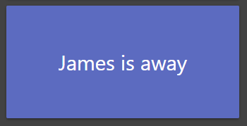

Hi @Stephane, present and not present is the state of the Presence sensor, and cannot be changed in the display of the presence tile. However, you can create a String variable, and update this variable’s value based on the presence sensor’s status in Rule Engine, and add this variable as a Variable Tile in the dashboard. (See below for example.)
And you may want to set this variable tile’s security option to “View Only”, so it won’t do anything when tapped.
