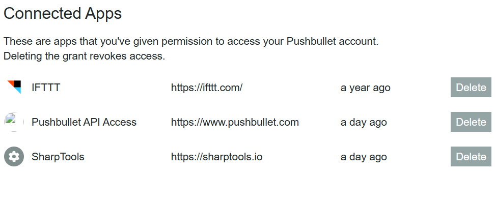

Hi William - I would start by double checking that you used the same Pushbullet Login Credentials on the Pushbullet mobile app and when authorizing Pushbullet to SharpTools.
When you use the Action → Notification → Pushbullet, you should see the list of devices you have authorized to Pushbullet.
From a quick check, I believe this should be the same list as what you see in Pushbullet Settings → Devices… which reminds me that I need to delete some really old devices!
