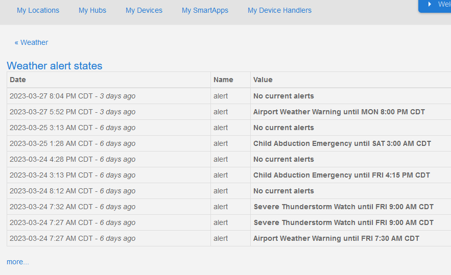

I checked the history of Alert attribute in the IDE and see it hasn’t matched the value I see in SharpTools anytime recently:
