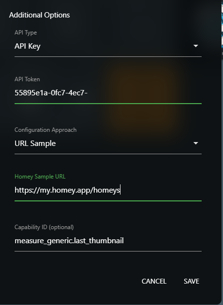

In Sharptools I have a tile, which shows me the picture of my Arlo camera. This worked without problems. No, I have the problem, that the Tile looks empty:
The tile configuration looks like this. This is an example, how it looks, i deleted some points for this public screenshot:
Do you have an idea, what could be the problem?

In Sharptools I can see the url and when I try to open the https URL on my browser, it works. But it shows me the picture not on sharptools.
Hey feron,
Thanks for the screenshots. Two things jump out:
  1. On the attribute view, genericMeasurement is grayed out with the note that it has no event subscription, so SharpTools may be holding a stale URL. Make sure the tile is on a saved dashboard (not only Preview), or re-add the Thing / Super Tile to the dashboard so subscriptions for that attribute get created, then check whether a fresh Arlo URL shows up when Homey updates the thumbnail.
  2. Arlo “last image” links are usually short-lived signed AWS URLs. They often open fine in a new browser tab, but a Media tile can fail if Force Refresh appends cache-busting query params and breaks the signature. If this is a Media tile/resource, try turning Force Refresh off: Media Force Refresh Setting. Background on Media tiles: How do I add video / images to a SharpTools dashboard?

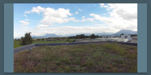

With the Homey Tile, the picture showed the entire tile. But with the Media tile it looks like this and I have left and right spaces. Can I configure the Media Tile, that picture will shown up the whole tile?
Thank you very much.

Those left/right gaps are expected with that tile. It uses object-fit: contain, so it keeps the full image and adds empty space when the tile shape does not match the photo. The older Homey Image Viewer used object-fit: cover, which fills the whole tile and can crop the edges.
There is not a built-in “fill tile” setting on Media Image Display today. Two easy options:
  1. Resize the dashboard tile so its aspect ratio is closer to the camera image. With contain, matching the shape removes the side gaps without cropping.
  2. Edit the Custom Tile CSS so it fills like Homey did. Open the Media Image Display tile in Developer Tools (Custom Tiles), find the #media-image style, and change it from max-width / max-height plus object-fit: contain to:
