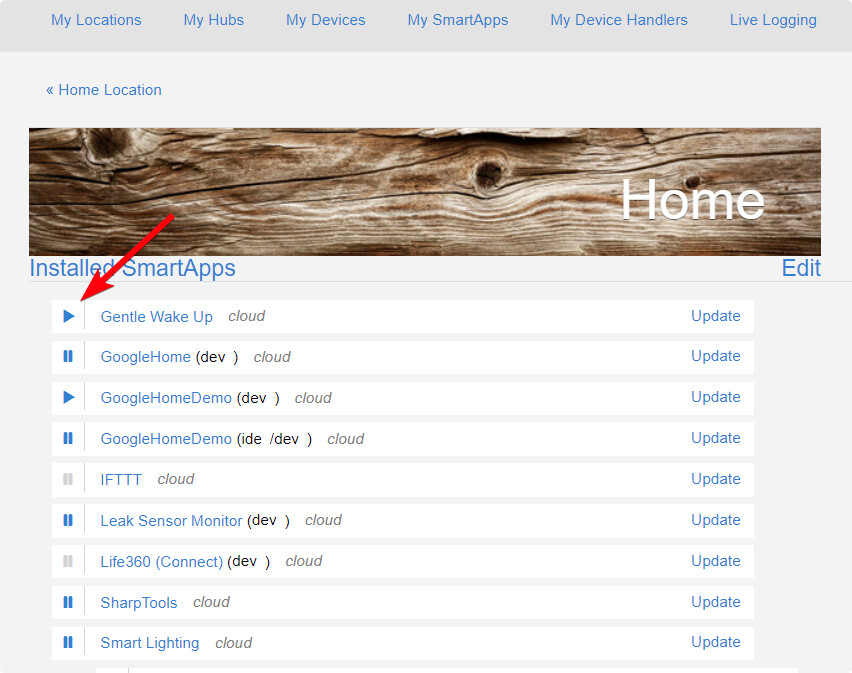

Have you check the Live Log in the SmartThings IDE site? It may give you some clues why it stopped working for you. Meanwhile, you may want to stop and restart the Device Monitor’s smart app in the IDE site under Location, List SmartApps, and tap the button next to the Device Monitor smartapp. See the screenshot below for an example.
