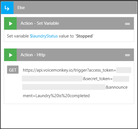

Else Side of Main IF Condition (Variable Stays)
The last part of this is the Else side of the main if condition which checks which type of event we’ve received. If you recall from further above, we know that if the type is not device, then it must be the variable since those are the only two types of triggers we have in this rule.
And since the IF condition already applies a set of conditions (eg. the $laundryStatus variable has stayed the value ‘Low Power Cycle’ for three minutes, we know that our condition for sending the notification / announcement is already met.
So the Then side of the main condition is basically just resetting our $laundryStatus variable to Stopped (in case we use it on our dashboard or somewhere else), then proceeds to trigger an announcement on an Echo Device using Voice Monkey.
James linked to a nice video by Justin from SimplySmart explaining how the last action is working, but Voice Monkey is basically a service that can play announcements on an Echo Device. So this step uses the HTTP Action to trigger a Voice Monkey Announcement.
