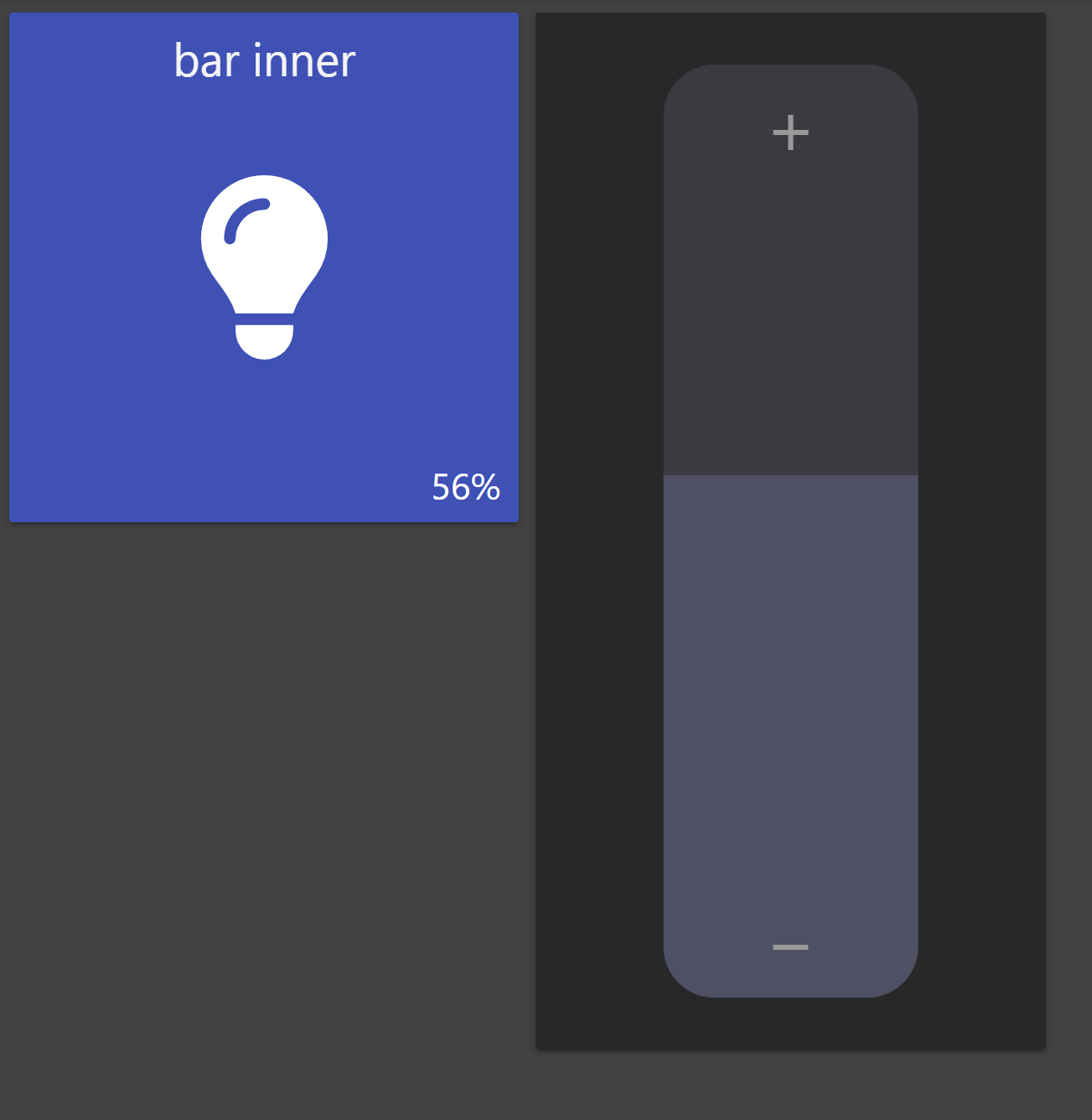

Vertical Range Input (Slider/Dimmer)

This is a great tile Josh but its really missin the ability to see if a thing is turned off or not and perhaps adjust reflect same with a different colour or ad a text/button that reflects the state of the thing (if wall dimmer is turned off the custom tile still shows dim level). The other tiles you have reflects on / off state with colour but this custom tile for some reason does not. So its not an issue of the thing itself but seems related to the script of the code? Thanks your input and help on this as its quite important for the dashboard to function properly. Cheers.

It’s currently only designed for Vertical Range Inputs. In theory, the code could be modified to support a horizontal arrangement if someone from the community has the requisite skills and wants to submit a patch / update.

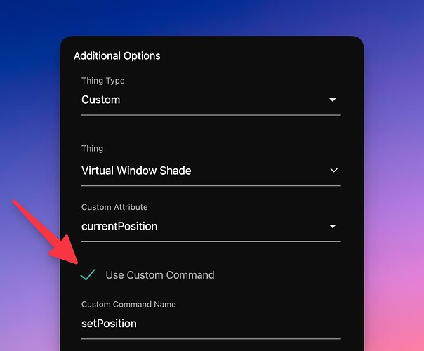

sry for such a long delay - I just got frustrated and gave up on this because the lack of time. Now I decided to try again and I started with this very good post from you.
Regarding the Network tab of my browser Dev tools, I can see the command “serCurrentPosition” was sent, with the argument changed to the new value, which is ok.

  • I can normally control for example the LED strip level using this custom vertical slider when I select “Switch Level” type
  • to control the blinds I have to select “Custom” thing type and after that I can’t control the blinds no matter which “Custom atribute” I select

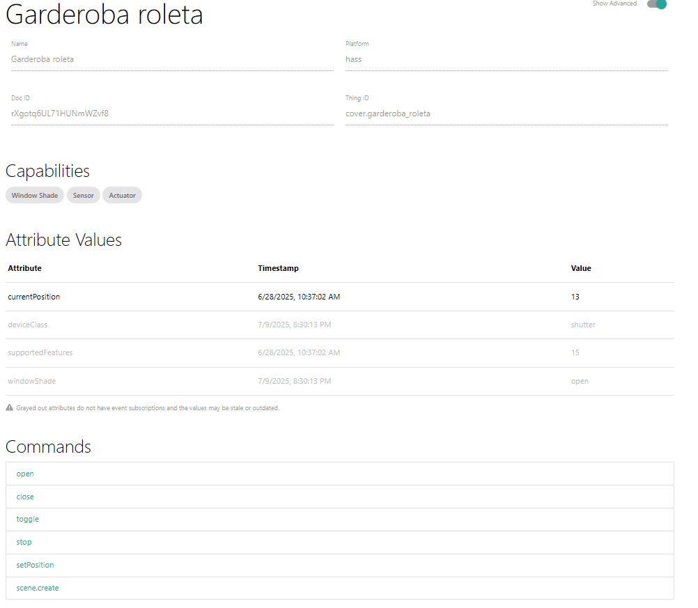

Here is also the snapshot of the details about the device you requested.
Ah, I see the issue. For custom attributes, the custom tile infers the command associated with an attribute as the format setAttributeName() as that’s the standard that’s used in officially defined capabilities.
So normally we might expect mappings like:
But looks like this device implements it as:
Attribute Command
currentPosition setPosition() :warning:
So the custom tile is expecting the normal convention of setCurrentPosition() and trying to use that, but since the device doesn’t implement that method it’s of course failing.

I pushed an update to the Vertical Range Input custom tile that adds a new Use Custom Command setting that when enabled lets you specify the command you want to use.
:stop_sign: You can use the steps from Update Imported Custom Tile to pull in the latest updates.
Once you’ve updated to the newest version, you’ll be able to check the Use Custom Command box in the tile settings on your dashboard.
Then you should be able to enter setPosition for the Custom Command Name field based on the screenshots you shared previously.

I also added a note to our internal issue tracker to take a closer look at this particular Home Assistant device mapping. I would have expected it to map over to an attribute of shadeLevel and a command of setShadeLevel() rather than your currentPosition and setPosition().
You mentioned that you can control things with the Window Shade Tile, but I presume that was with the standard open() and close() type of commands. The quirky device mapping is also probably preventing you from seeing the position percentage on the Window Shade Tile and thus preventing you from using the dimmer style range control in the Window Shade Tile to adjust the position between 0-100%.
Perfect, now it works, thanks a lot!

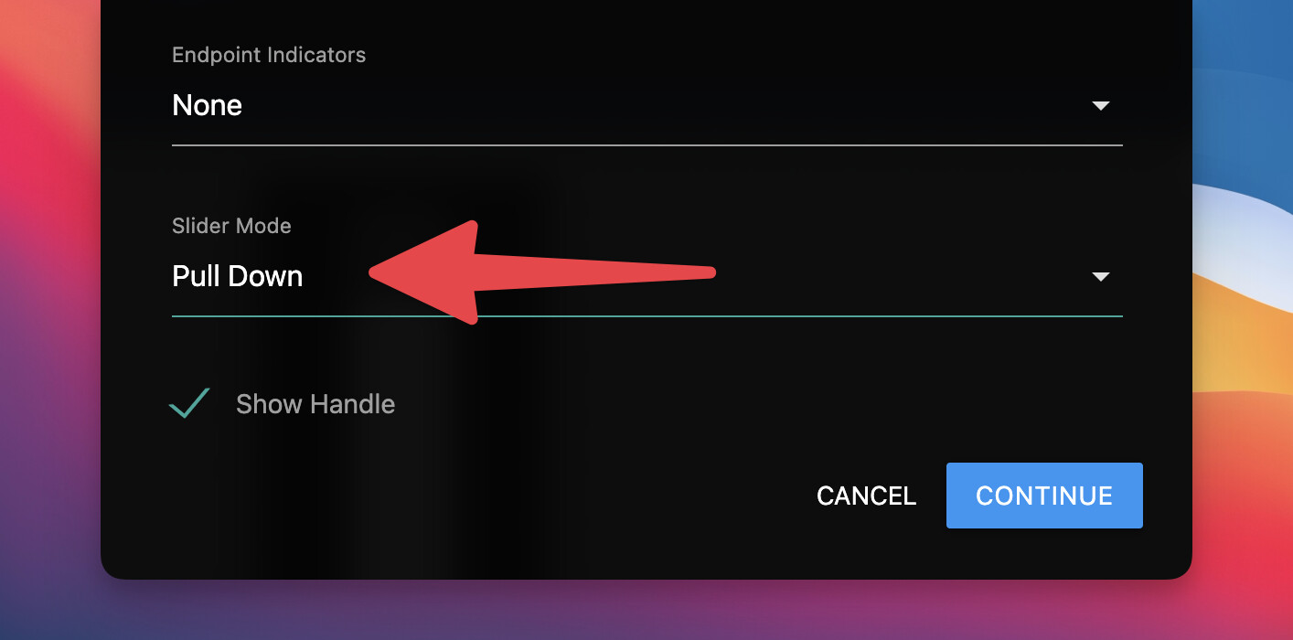

The only thing I can’t get is top down handle. Slider is now fully functional, so it’s not really important, but I don’t know how some guys did it. :smiley:
It’s automatically inferred based on the attribute used. I pushed an update that lets you override this for Custom Things.
After you Update the Imported Custom Tile to pull in the latest updates, you should see a new Slider Mode option which you can explicitly set to Pull Down
Thanks a lot, it’s done!

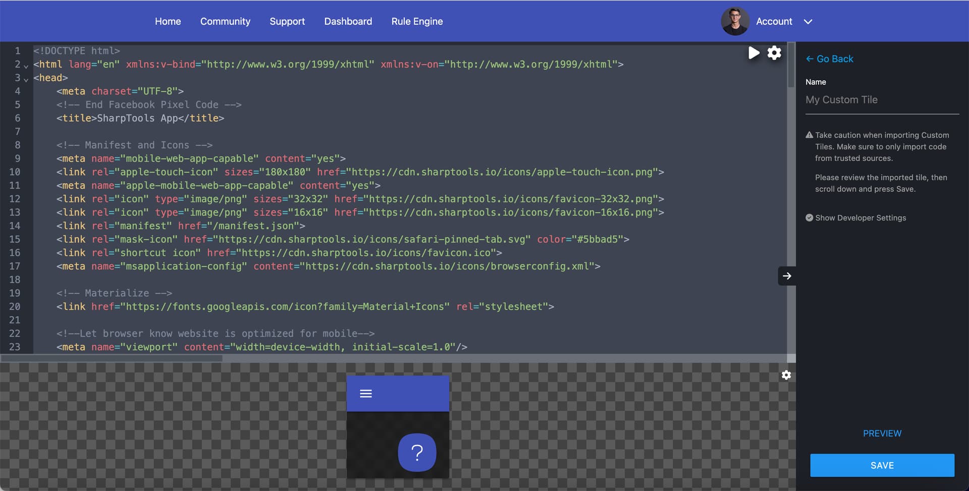

Hey all – just started building my first few dashboards with my Hubitat C8 and SharpTools, but am having trouble importing this custom tile. The import button on the first post in this thread doesn’t seem to pull in the right code. Is there somewhere else I can find the original file?
I just fixed the URL in the first post. Can you try it again?
That worked – thank you, Josh!

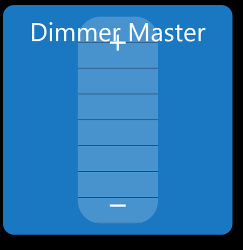

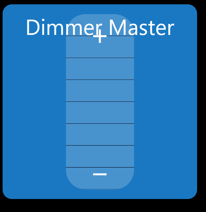

I really liked this tile, but I would like some help:
  • Is it possible for the tile to recognize that I added a label, thus reducing the height of the adjustment bar?
  • If using style, is it possible to specify colors for the switch to be on or off, or even the level?
I even tried to do something like Claude.AI, as you recommended, but it can’t understand where to get the information about whether the label is checked or not. It’s the same situation in the second case because the style is directly from SharpTool.
