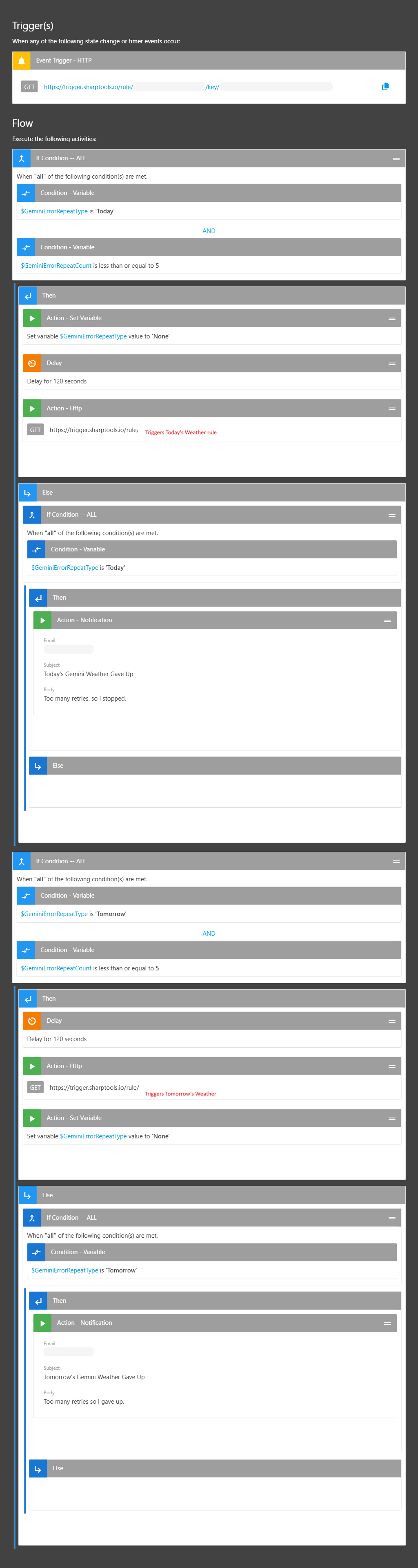

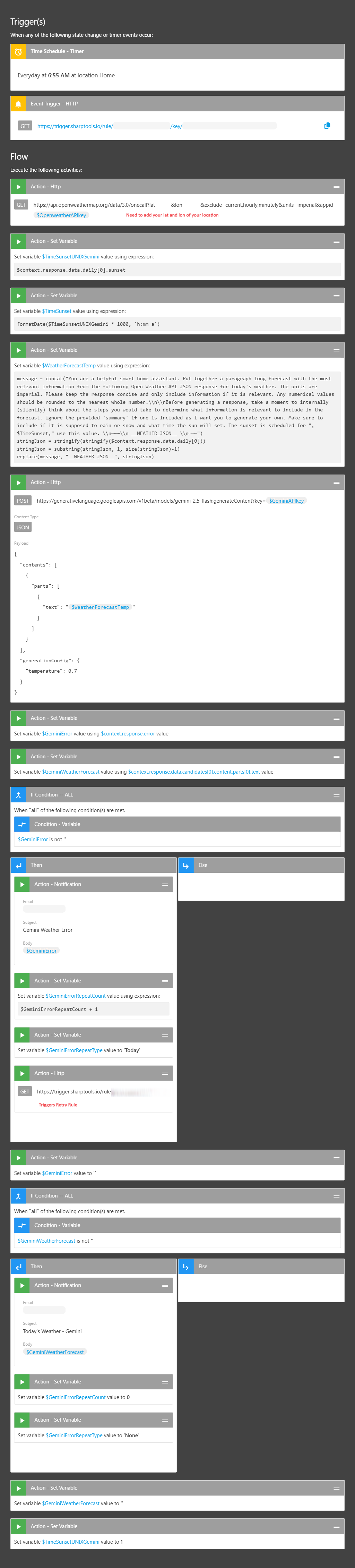

I recieved an email from OpenAI that the model @josh demonstrated with was being depreceated later this year. So I looked at Gemini and they have a free tier that gives you 20 calls per day. If you’re just doing weather a few times a day, it works well. I did have to set up an additional retry rule, as sometimes I was getting a “too busy 503” error, but it mostly works first try. If anyone is interested, let me know and I can post my rule and retry rule. Cheers!
Hi @Zach_Imler, I am very interested and would like to see your rule!
@Wet.Blanket Here you go! This is the “Today’s Weather” rule and the retry rule. The retry rule is set up to run for either my “Today’s Weather” or “Tomorrow’s Weather” rules. The retry stops after 5 attempts and is set up for a 2 minute cool down before hitting Gemini again as there are rate limits per minute.
Today’s Weather
Retry
I’ll do my best to answer questions :smiley:
Edit: Found a slight logic issue in the Retry Rule and updated it
This is great, thanks for sharing. I’m going to find some time next week to try this out - I been wanting to do something similar/same. Thx again!
@Wet.Blanket found a slight logic issue in my retry rule and made an update, then updated my original post.
